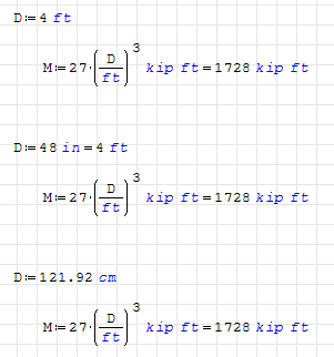

What Davide said or understand where the constant comes from. You'd be surprised how many people "forget" how the constant is derived. SMath carries the units and modifies as needed internally... Derive Constant.sm (3,76 КиБ) скачан 1200 раз(а).

![2016-03-28 23_43_53-SMath Studio Desktop - [Page1_].png](/ru-RU/files/Download/FTrS4D/2016-03-28-23_43_53-SMath-Studio-Desktop---[Page1_].png)
