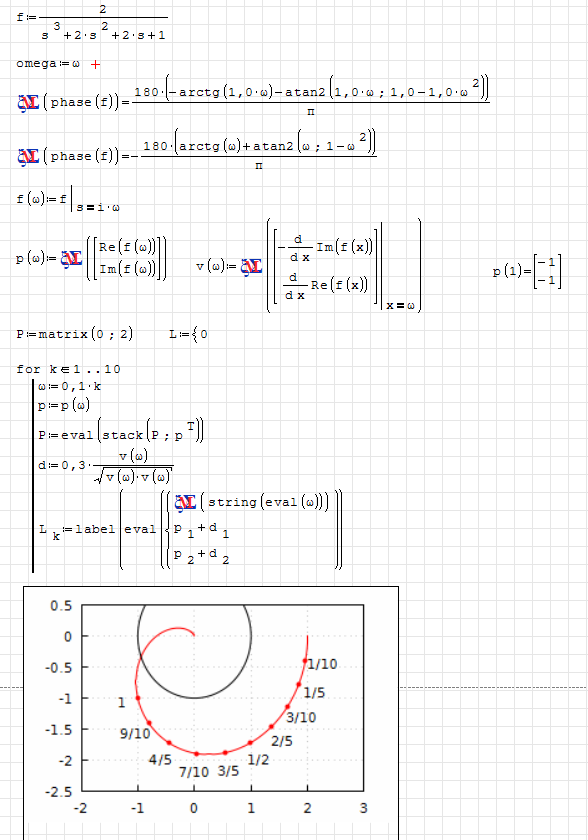

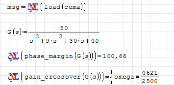

You can use the coma package with Maxima. However, the plot functions need some special treatment. If you can ask them to export the image to a file and get the filename, then you can display this with an image region.
Please find attached my experiments with the coma package. It is on my agenda to enable the plot functions.
coma.sm (336,97 КиБ) скачан 1068 раз(а).
