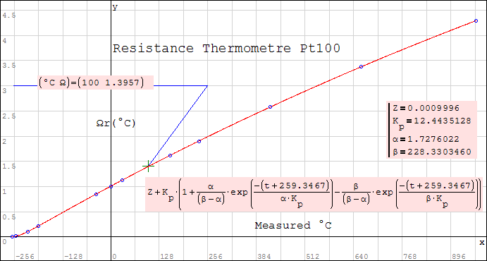

God gave us temperature but not the thermometre !
Now, Smath gives us back the thermometre.
In many symbolic applications, Smath/Maple is
superior to Mathcad 11/Maple. Observe passing
a long equation as "argument".
Inst_Pt100.sm (50,45 КиБ) скачан 1151 раз(а).

... final refactored.
Inst_Pt100.sm (55,79 КиБ) скачан 1140 раз(а).
