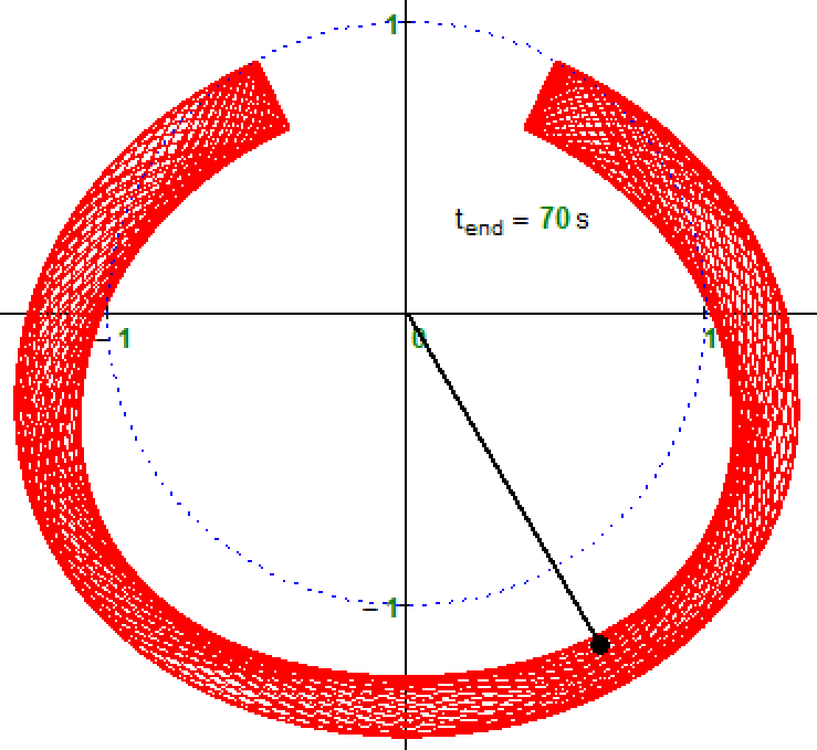

In this version you can specify the initial force in the spring. The initial conditions for x and y are adjusted appropriately. ...
A comparison between Martin's solution and that given by the equations of motion obtained from the Lagrangian. Spoiler: both give the same result.
I'd like to point out how incredibly complicated this problem actually is, and what a series of brilliant implementations Martin makes. For example, where the hell does he get the time derivative of the force on an elastic bar when he is given only the length of the bar as a function of the force? Obviously, it is not enough to apply the theorem of the derivative of the inverse function, but you also have to have a deep knowledge of the mechanics of the system to remember something called tangential stiffness, and although it uses k to represent it, we forgive it because It's German and they are well known to use their own abbreviations. Well, actually I don't know what letter to use, because I don't remember ever using that magnitude for any practical purpose, but in Spanish literature it is quite common to use k for its inverse, which is the constant that appears in Hooke's law. Or at least I think so, because the existence of elastic bodies is actually a complication, they should all be rigid better.
Another notable thing about this example is that I would like someone to please explain to me how the hell the Viacheslav plugin manages to handle l'(t) within the equations, because I honestly didn't expect it.

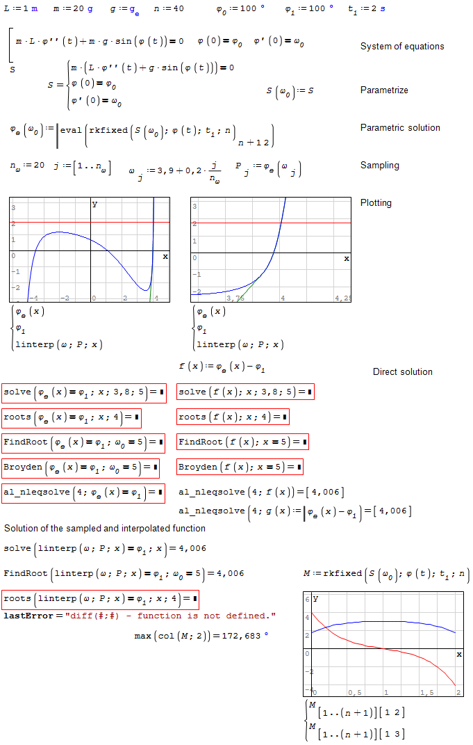

Trying to solve a boundary value problem (posed by Valery): find the required angular velocity at an given angular position such that after a given time the pendulum is at a specified angular position
Here we try to get from 100° to 100° in two seconds. It turns out that we have to give an initial velocity of approx. 4 rad/s. The pendulum approaches north pole and comes back just in time. There are infinitely many solutions, if you allow for additional full rotations before the target is reached.
Most of the time I spent on finding a way to embed the numerical solution of the nonlinear differential equation into a numerical solver.
Unfortunately most of the solvers are "special needs" solvers. It is unclear why something can be plotted but not solved. And hardly any good error message. Exception is al_nleqsolve, which gives particularly helpful messages.
Any improvements or insights welcome.
Pendel NL RWP.sm (25,26 КиБ) скачан 1549 раз(а).
#28 Опубликовано: 09.12.2023 16:54:12
Hi Martin. I guess that your issue is that the end angle is 460 degrees, not 100. You can also see this post.
bvp2-pend.sm (145,59 КиБ) скачан 1570 раз(а).
#29 Опубликовано: 09.12.2023 22:42:50
That circle looks weird.
Circle_solve at(2).sm (12,15 КиБ) скачан 1537 раз(а).
#30 Опубликовано: 10.12.2023 03:55:10
Thanks a lot for the hints. In fact, my issue was how to handle the problem with the other solvers. Yet, you seem to prefer al_nleqsolve(), obviously for good reason.
Your bvp-procedure is impressive, it should go to the kernel or at least to a plugin.

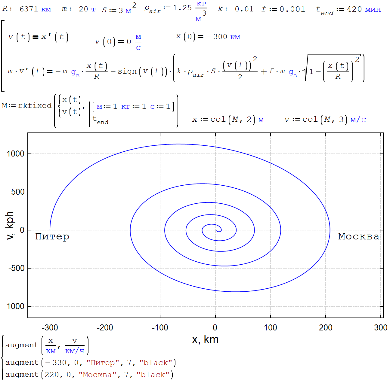

Well, who will be the first to create a calculation for a damped pendulum suspended on an elastic rod?
Fig-13-GravityTrain.sm (13,62 КиБ) скачан 1496 раз(а).
