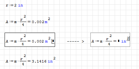

Calculating Area of a piston when I enter the diameter in inches the output is m2, how do I get the output units to in2?
Copy inch²/paste in the empty place holder of result.
#3 Опубликовано: 15.07.2020 16:58:18
598 сообщений из 1 379 понравились пользователям.
Question:
Thanks and apologies if this is something easy to solve, I have searched all over and have not been able to figure it out.
Click to result, you wil notice there will be a placeholder for unit change.
Change it to square inch. It will be calculated as you wanted.

#4 Опубликовано: 15.07.2020 16:59:34
... or like this in silent unit:
1. x*in ... in from unit panel
2. backspace twice to remove in
3. at this point you see a big round place holder,
4. in that special place holder ... in from unit panel
5. 'in in blue is now silent for result 'in²

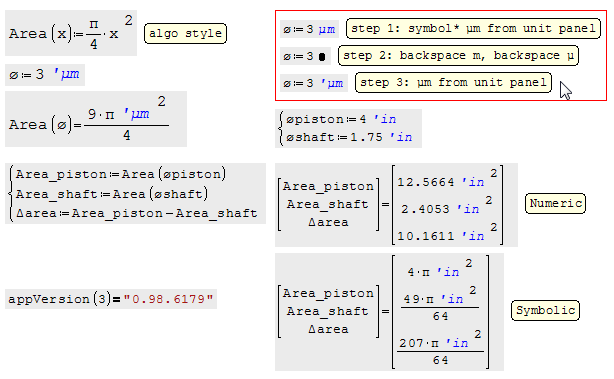

#5 Опубликовано: 15.07.2020 18:29:56
... make it hi-pro algo style.

#7 Опубликовано: 15.07.2020 19:10:51
Cannot figure out the syntax of how to changes the units
... as explained above. Read again.

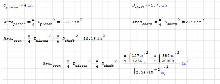

#11 Опубликовано: 16.07.2020 11:41:59
tonlok
tonlok
Once again, I want to thank everyone for their help.
I am going down the path of using the units. Took me a couple of attempts to get the in2 but it is now working
One follow-up, if I set the equation to optimization none to show the numeric values they all default to meters, is there a way to have them shown as inches?

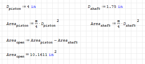

#12 Опубликовано: 16.07.2020 13:33:43
Construct as is, it may have to do with your SS version.
Otherwise, you are wrongdoing, not following guidance.
#13 Опубликовано: 17.07.2020 04:29:22
1 353 сообщений из 2 265 понравились пользователям.
Definitions are converted to SI upon storage (you see that when you hover with the mouse over a definition. Control of display units is just by the optional placeholder, where you can insert any factor (a unit or pi or any variable name which your result may contain)
Also note that the default display unit depends on optimization. Numeric and symbolic display different units, e.g. 1/s defaults to Hz in numeric optimization and to 1/s in symbolic.
