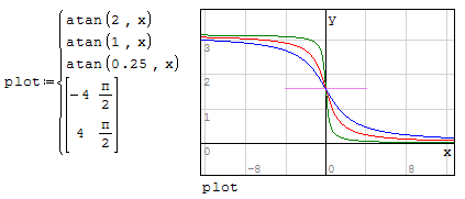

#3 Опубликовано: 30.03.2020 14:02:58

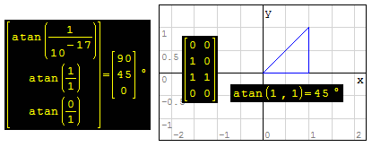

#4 Опубликовано: 30.03.2020 15:14:50
#5 Опубликовано: 30.03.2020 17:15:25
It took me a great deal of effort to figure out why the complex atan function returns the wrong result.
complex atan = atan(2)
Nothing wrong Smath native code atan(2)
#6 Опубликовано: 30.03.2020 18:22:03

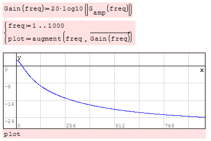

There are a few issues that tripped you as well based on what I am seeing in your Direct Domain version of the file. The original Mathcad file I was attempting to convert to Smath Studio so I could promote its use with my colleagues used an indexed datapoint stacking method with n=0 to 200 in increments of 1 to compute the values of the function.
Zedgraph cannot work with that data structure setup. It literally handles the equation evaluating without you knowing about it how to a number you specify when you set up Zedgraph.
Since I am not a software programmer, after looking at the Zedgraph source files posting I could not figure out how it is internally set up.
In Electronics Engineering that I am practicing since 1976, Bode Plots are essential. Zedgraph is the only way I found where you can set up the frequency scale logarithmically so that it would present a Bode Plot correctly in Smath Studio.
Based on you checking out the atan2 function and the bad result in Zedgraph I am venturing to say that the issue might be within the Zedgraph plotting engine and not in the Smath Studio software.
So this post of mine should go to someone who is either willing to jump into Zedgraph or create a similarly functioning plotting tool for Smath Studio. I am afraid to say that the standard Smath Studio plotting tool is a bear. It is very difficult to work with not being able to set it up as you wish and it completely lacks the logarithmic scaling functionality that an Electrical/Electronics Engineer would need as presented in my example.

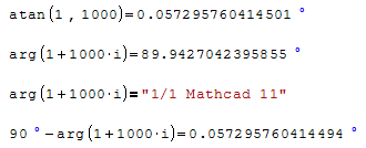

I understand. Also last night after I got off teleworking I investigated the issue a bit further. I was wrong, the issue is not Zedgraph, it is how Smath Studio interprets atan2. I compared that with Matlab and Wolfram and both interpret it the same way as Smath Studio. Mathcad is the outlier here by following the Electronics Engineering definition of complex arctangents. Too bad but I believe this difference can be overcome with writing a programming function in Smath Studio to do that. I am not the best with these programming structures, my mind works a little different but hopefully will be able to do that on my own. It might take some time, but that is OK.
Thank you for looking into it.

Oh ! my friend: calm down coding Smath/Mathcad
atan(2) was controversed in Mathcad up to 11.
In fact, Smath that is more largely based on universal libraries
often detects wrong MCD code, though not wrong within itself.
example: UnitVector(x):= x/|x|... nonsense as such coded Smath
Smath... UnitVector(x):x/norme(x) ... universal compliance.
UnitVector was detected while solving Quaternions.
there are more occurences [3D axes system].
