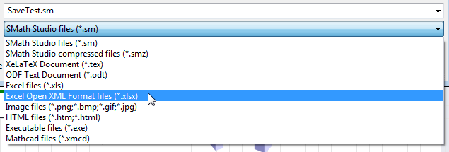

It is because the XLSX export seems to be broken and I don't know what extension is responsible. If I try to export my standard export test to XLSX SMath gets into trouble.
SaveTest.sm (67,06 КиБ) скачан 971 раз(а).

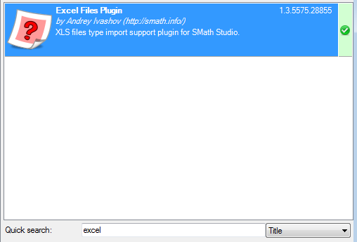

I guess it is "Excel file type" plugin by Andrey:
BTW it work for me
