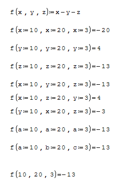

I was wondering if it is really necessary to provide the function arguments in uni's linq example both with the right names in the inline assignmants and with the right position in the argument list. And in fact, sometimes you really can mix the order. However, this does not work always and I am not able to find an explanation, when this works and when it does not. Another issue which adds complexity is the question, which of the inline definitions is visible outside.
This provides limitless options to hide your design intent from uninitiated outsiders.

Maybe it's like this: first step is assigning all formal variables their symbolic values by place, then evaluate all symbolic values from left to right, executing all side-effects (possibly overwriting previously calculated params when name is reassigned):
f(x:=10; z:=20; y:=3)
=step 1=> x->x:=10; y->z:=20; z->y:=3
=step 2=> x=
=step 3=> y= - here y is 20, AND z is 20
=step 4=> z= - here z is 3, AND y is 3!
This explains all Radovan's samples, but not Martin's. Here's why.
