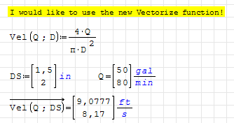

Jean will be proud (algorithm) and disappointed (would like to use vectorize)
I would like to know two things ... Vectorize and Program.sm (14,29 КиБ) скачан 1238 раз(а).
1) Can I convert my algorithm and use vectorize?
2) I want to pull the diameter that corresponds to greater than Vel.min

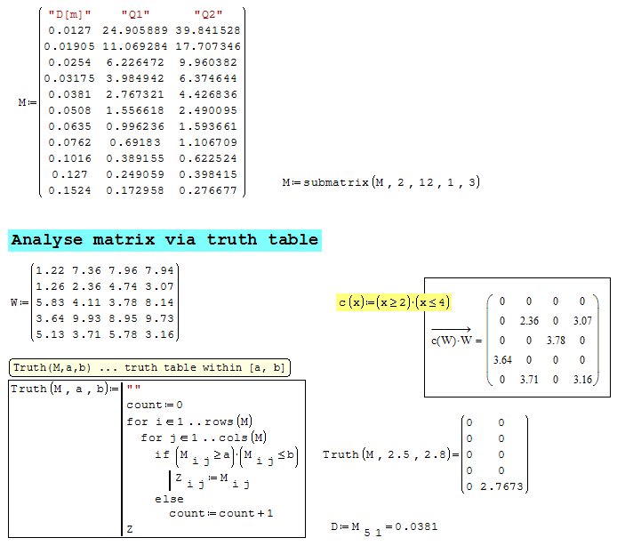

You can supply the data table to piping designers, and live them finish the work.
In 1987 and earlier, piping designer used a glorious software "Massbal"
At this time, none of these computing gadget existed. Vectorising does not apply
in your project. Smath is not equipped to search in table. For a unique scientific
application on long data table, one would have to design a lot of modules.

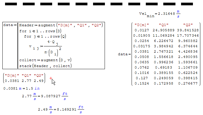

Vectorize and Program.sm (28,05 КиБ) скачан 1228 раз(а).
Thank you. Never used Augment before ...
Not for the piping designers, for me to double check other calculation. Everything is off of "packaged" software and I like to double check the maths. Curious if a second routing can be used to solve for the the D. If V.i,j>V.max keep solving, else, stop. Putting kids to bed and will look into that

Just remove erroneous declarations, and use DS in function invocations (your D variable is defined having 11 rows, Q has 2 rows, you should use DS having 2 rows).
Vectorize and Program.sm (14,58 КиБ) скачан 1248 раз(а).
P.S. My screenshot is just a follow-up of previous suggestions (Jean's and CBJ's).
My sheet is another approach without any loops, just vectorize() end eval().

Virus on fresh computer ... had to restart. Never let spouse, kids, etc on administration account ... "just to check email".
CBG is more of what I envisioned. I don't understand the array variable. Will need to put in my sheet to fully understand. I was going about it in a different way, this i better.
Mike, your solution is when I know the pipe sizes. I am solving for the pipe sizes from a data table ... essentially, they don't want to solve, they want to use the Crane manual.

From what I can see, tabulating some sort of useful data will be the other way around .
The first column is the Q [massflow rate], from which you calucalte the speed versus
the diameter. So, there will be as many speed column as there will be diameters.
Doing so: the data table will be visual for checking. QA controllers, they don't care
gadget calculations, they go by the book. Also, consider what a CAS like Smath can do.
The truth table is not a gadget, it is almost the only tool to search in data table
that dont have integer values , though you can round off but can't surely round the speed
to integer values.

What's wrong with the counter? Getting "0" for first output, not 1.5.
Vectorize and Program a.sm (9,56 КиБ) скачан 1202 раз(а).
You have an error, the "Line " command should be in the second loop.
Annex corrected fileVectorize and Program a_r1.sm (9,57 КиБ) скачан 1244 раз(а).

- CBG, you counter was what was perplexing me the most. This is originally what I was after Answer.smz (3,22 КиБ) скачан 1184 раз(а).
- Jean, you always say to be get inspired. After looking at your table, I expanded on my output Answer with Table.smz (3,64 КиБ) скачан 1196 раз(а).
