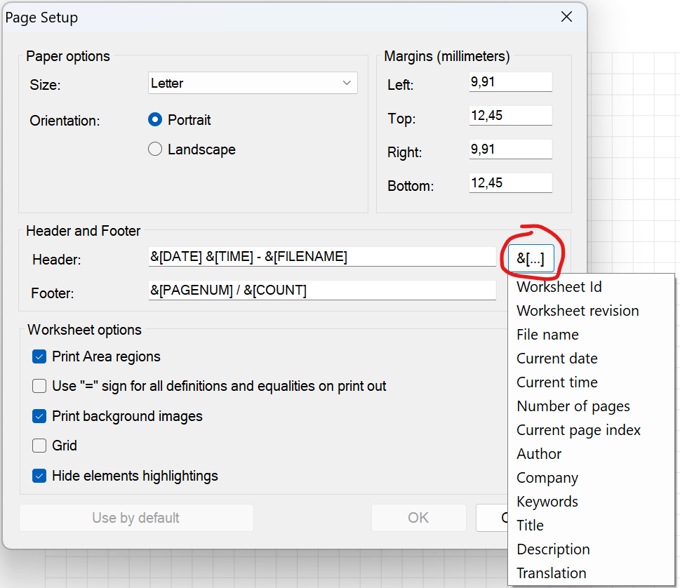

Page Setup dialog improved to allow selecting available substitutions from the dropdown lists for header and footer;
It is about these buttons:
