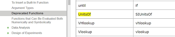

Hi. I think that SMath's UnitsOf() it's well defined, not like the equivalent in Mathcad, which it's deprecated
and substitute by SIUnitsOf(), even the Mathcad error was related with the default unit system setup (SI=MKS, FPS or CGS): https://support.ptc.com/help/mathcad/en/index.html#page/PTC_Mathcad_Help/example_explaining_SIUnitsOf.html

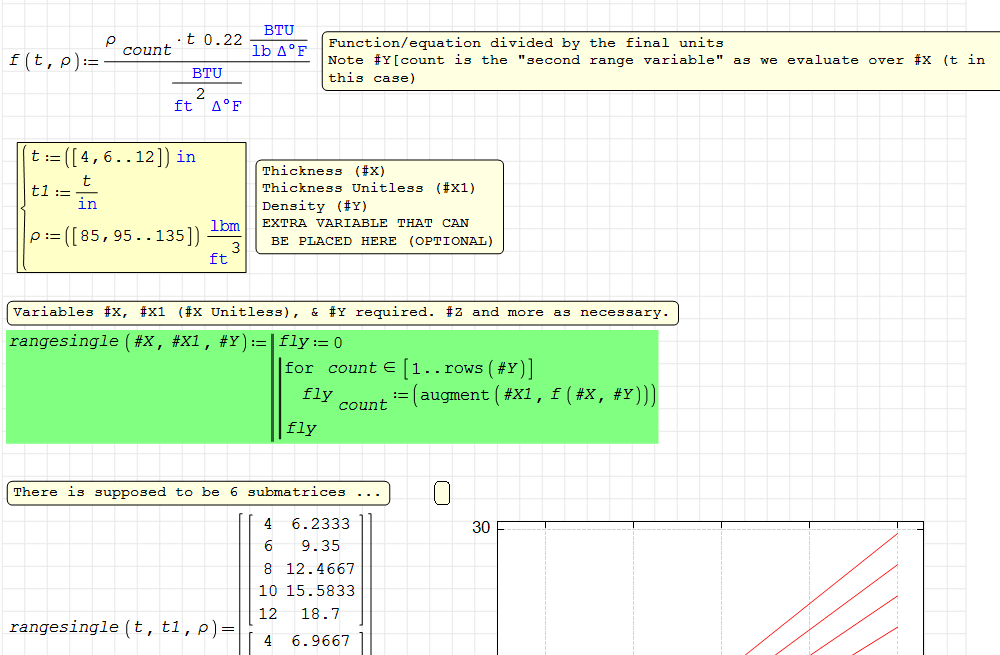

Let's take a step back and look at the Heat Capacity sheet.
This is the one you could not open, so I'm posting the revised function below. In this example (you have your sheet to look at), I just want to eliminate the variable #X1 as all it is is the variable #X unitless. As mentioned above, I just "defined" #X1 as #X/units and we are fine. I am updating calculations to use this "generic" function for consistency. I was just hoping to eliminate having to define #X1 as a separate variable ...

#11 Опубликовано: 22.01.2021 00:35:12
Ruben Sidranski
Ruben Sidranski
The intent of this thread was to find a built in function to to eliminate the units (my misunderstanding of UnitsOF()). In your screenshot, you have a multiplier ... in this case, 39.37. This is what I'm trying to avoid for other equations that might be in BTU. or FT, or "widgets". Lets move on to bigger items. The simple fix is to define #X/units (t/in in this example).
