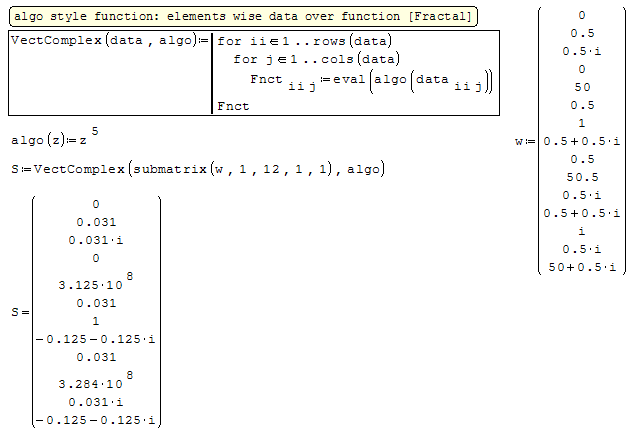

#9 Опубликовано: 21.03.2016 20:57:22
I recently discovered, that if I use vectorised operation on result ofsubmatrix(v,...) and sort(v) functions,
vectorised operation doesn't work, it needs eval(submatrix(v,...)) and eval(sort(v)).
The optimization of the code is, of course, NUMERIC.
...Igor
In Smath, many types of result must be transited, particularly chained functions.
