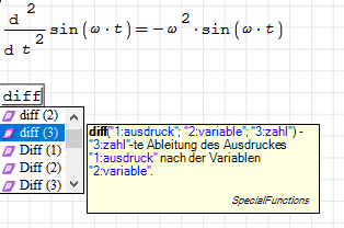

1 312 сообщений из 2 228 понравились пользователям.
It is not in the side panel but you can select it in the dynamic assistant or in the Insert functions dialog.

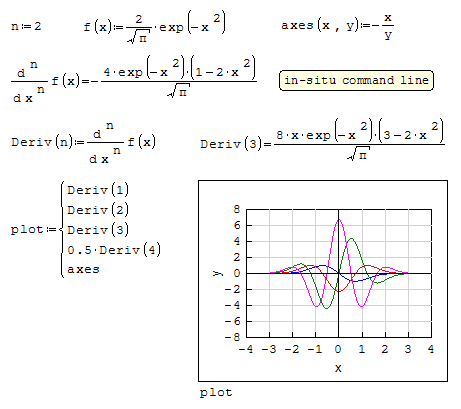

#3 Опубликовано: 29.05.2023 08:54:18
Is there the Derivative the 2-d order in SMath? I see only 1-st order.
As well, you can have multiple derivatives.
f(x) is the integrand of erf(x)
Cheers ... Jean.
