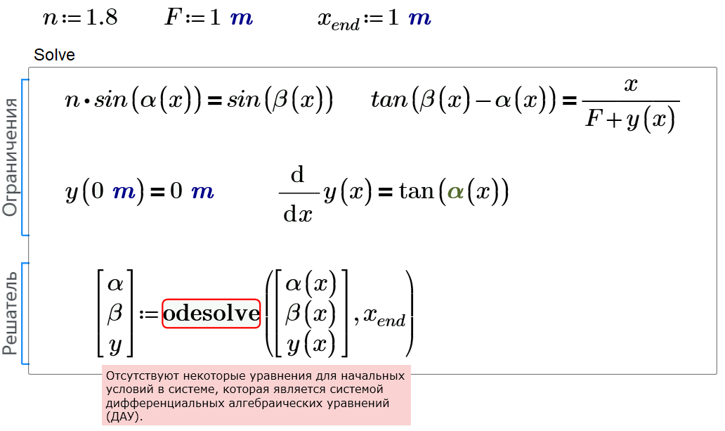

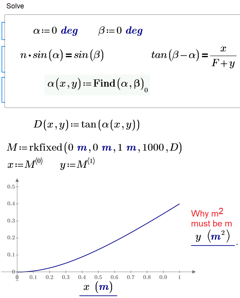

How can we use here a Mathcad-block?

WroteHow can we use here a Mathcad-block?
Here the function rkfixed() can't process the incoming expressions correctly. The block has nothing to do with it, it does not perform detailed analysis of expressions.
This is a bug in the function. The function has not been tested for this case. I can't see what's wrong here right now.

Question - why is the answer meters squared, and not just meters?

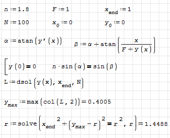

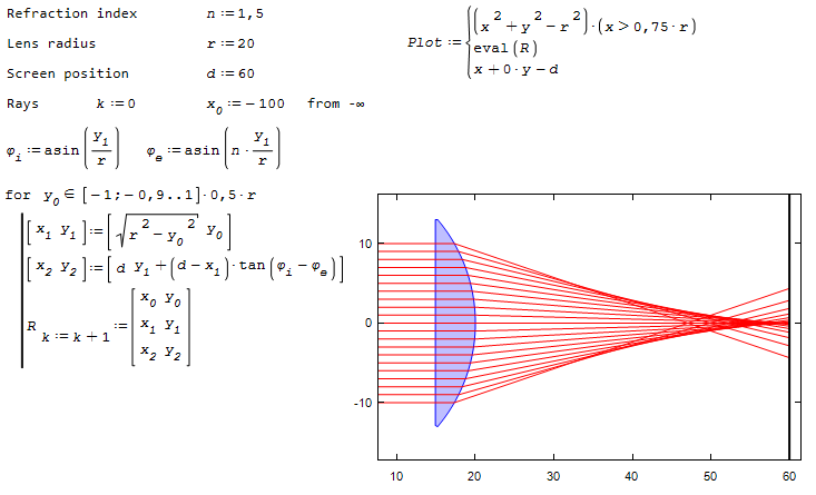

Hi. dsol can solve it with this setup:
RKA-Lens.sm (179,91 КиБ) скачан 1825 раз(а).
I also use the Martin's setup for the plot.

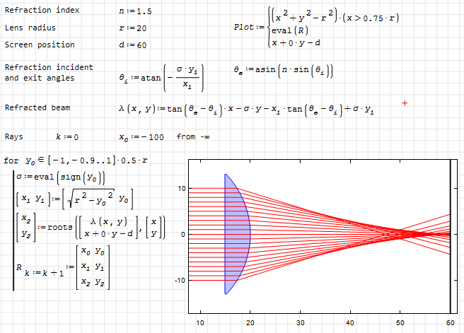

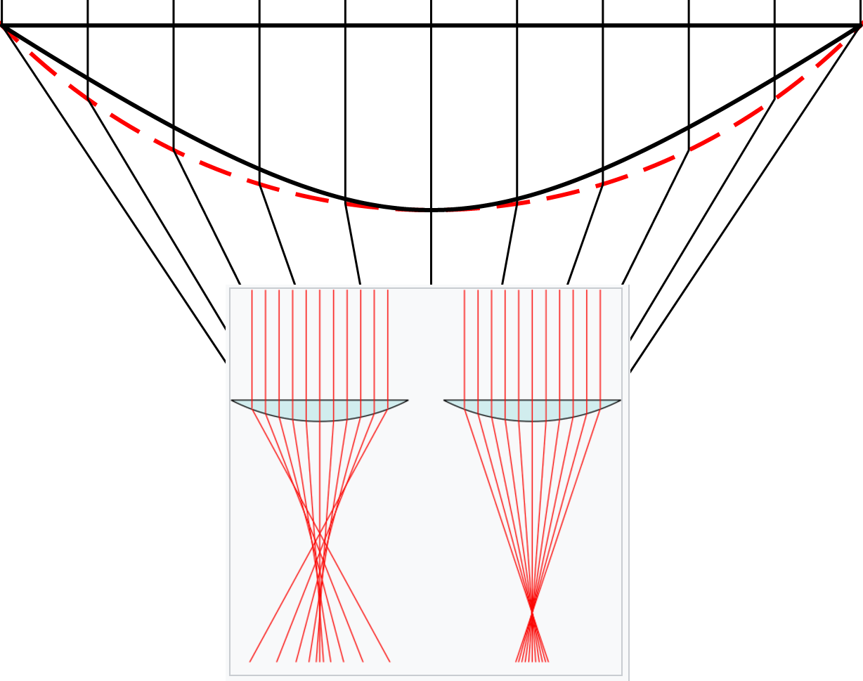

Hi Valery. This is a way.
spherical aberration.sm (15,88 КиБ) скачан 1815 раз(а).

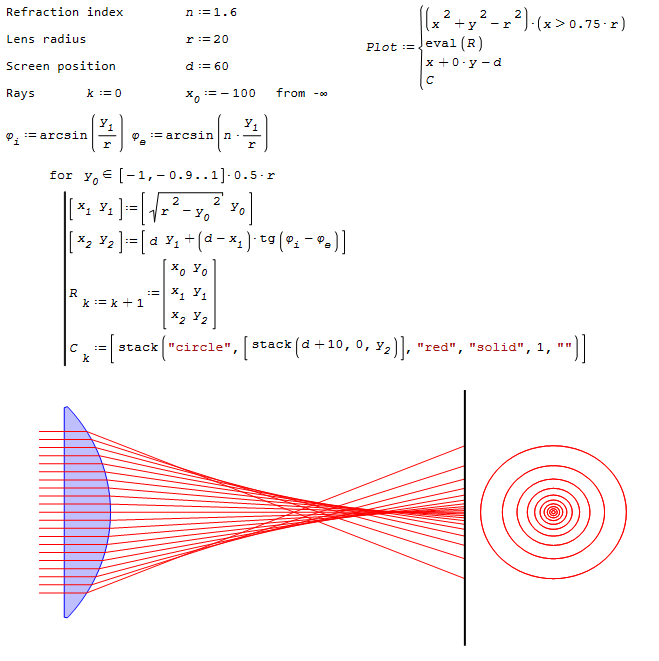

Hi. The screen. I also simplify a little the calculations.
spherical aberration.sm (26,41 КиБ) скачан 1974 раз(а).

WroteHi Valery. This is a way.
Very elegant solution
