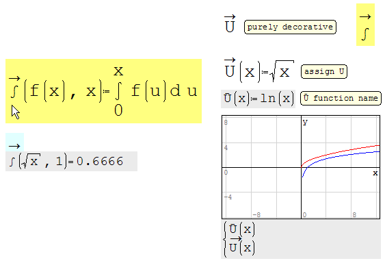

You can slide any decoration over a variable name
... or over a function definition ... even an arrow !

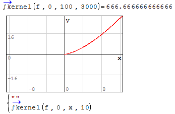

You can have some circomflex hat as well from Charmap.
All or most Charmap can bear function name, even single arrow.
Take care Basile ... old Collab ... Jean.
#10 Опубликовано: 07.05.2023 14:26:16
... the document for eventual projects.
Cheers ... Jean.
Maths Symbols DECORATION Copy.sm (17,26 КиБ) скачан 1197 раз(а).
