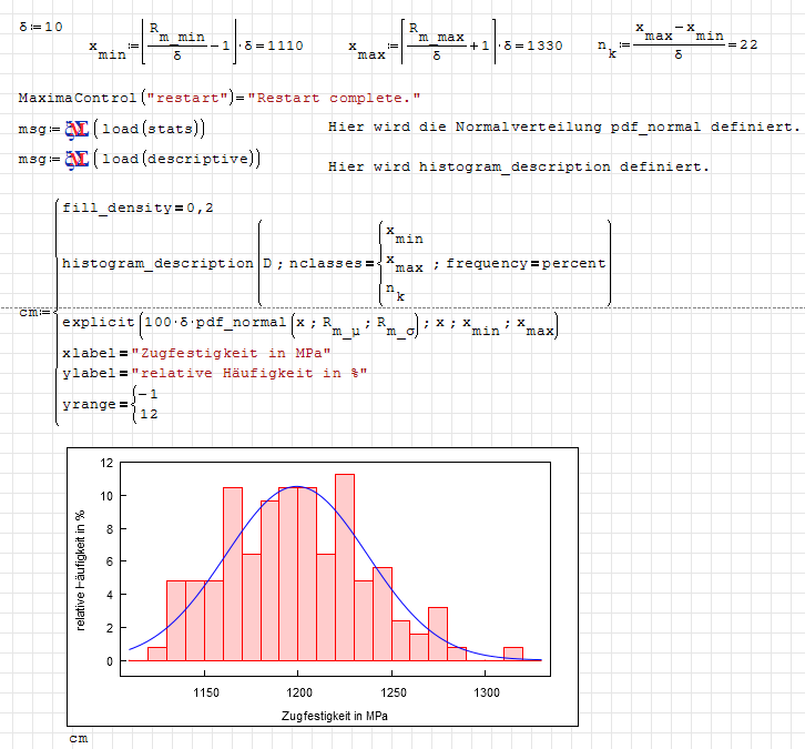

I would like to know if is there a function equivalent to MathCAD's 'histogram' function in SMath. I am willing to plot a histogram from data gathered from Excel but I could not find such function in SMath. Does anyone know a plugin or a function which could help me out doing so?
Thanks beforehand,
Regards.
Bruno

Here is an example adapted from a book on materials science with mathcad, using the maxima plugin and loading additional maxima packages.
Streuung.zip (20,91 КиБ) скачан 285 раз(а).
