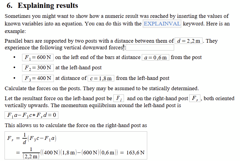

Is there any option to make smath show a numbers he calcualte, before a result?
For example if i write a=2 b=3 and then write a+b i will get a+b=5. I want smath to show a+b=2+3=5. is that possible? There is any addon for that?

Hi, this is not possible in SMath, or only with heavy workarounds.
I think you want something like this (as in Blockpad)
Also LibreOffice with the iMath-extension can produce such displays, yet you have to input some formatting codes in the formula editor.

how i can show that reference values?
ok, i found it! Thanks for help!
