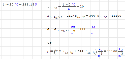

#3 Опубликовано: 27.02.2018 06:38:58
I would operate in the way illustrated. However, there are problems with the use of degrees Celsius
[albumimg]1470[/albumimg]

@mkraska: Thx, that did the trick.
@PompelmoTell: I was trying to do something like that but also had problems with °C because K is default unit. Thx anyway.
