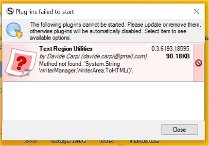

    But there is a problem with "Text Region Utilities" plugin to install.
    Davide Carpi 12.01.2017 12:17:00

    Thank you Davide.
    The update for "Text Region Utilities" is OK now.
    Thanks again; updated both the plugins (added another small performance improvement for print preview).
