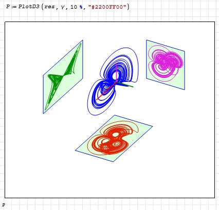

Hi. For show the four plots at once.
DadrasAttractor.sm (46,22 КиБ) скачан 965 раз(а).
Fridel Selitsky 27.07.2021 03:46:00

Thanks for the 3D image
