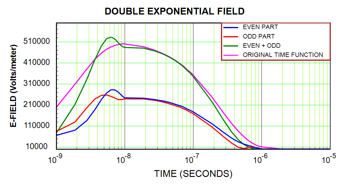

Being a brute force type of programmer, in the meantime, I decided to try something. I created a second calculation at negative times using the range variable as before. Now, I have a positive time and a negative time result from which to calculate the even and odd parts. The results are shown in the attached PDF for 30 time points per decade and 100 frequency points per decade. These definitions are in the blue area for time and orange area for frequency.
SMATH FILON TRANSFORM.pdf (627,18 КиБ) скачан 899 раз(а).
With the increased time and frequency points per decade, it runs for almost 4.5 minutes. The transform is very good. If I keep the original time and frequency points per decade = 10 as in my original submittal, it runs for 7.6 seconds; however, the transform is not very good as shown in this figure.

Three lasting issues:
1. The transforms should be real as in MATHCAD. In SMATH they are complex; therefore, I plotted the absolute value as a sort of workaround. Have not had the energy to work through the algebra to prove the transform should be real.
2. Is there anyway in SMATH to include the text about spacing h and frequency points per decade on top of the graph? I placed it below because it always appeared under the graph if I tried to place it on top of the graph.
3. The graph is a ZED Graph. Is there anyway to express the y-axis with exponential notation without resorting to a log scale?
