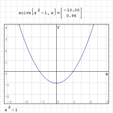

Hello, please tell me what is wrong with this function?
Solve problem.sm (2,86 КиБ) скачан 1179 раз(а).

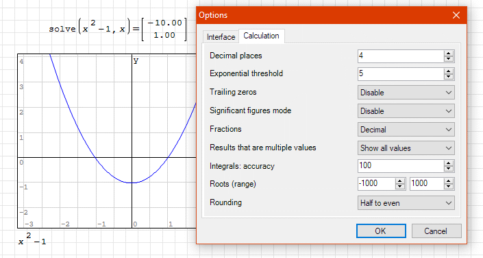

The solution method is numeric and depends on the search limits of the roots. By appropriately setting the limits to the nearest values (Tools->Options->Calculation->Roots (range)-10 + 10), you get the correct result. Downstream of a numerical solution, it is always necessary to proceed to the direct verification of the result (sanity check).

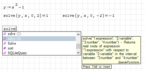

Use solve(4) instead of solve(2). The one with 2 arguments it's handly for calculations on the fly, but not reliable for structured calculations.

If you put some big range, you get wrong answers, like in this picture

You can't. Solve with default range for search "all" the roots it's just a helper for some easy calculations. If it give the correct answer, good, but if not, there are not to much to do.
For that you must to use the solve with 4 arguments (or other numerical solver), and get the roots one by one.
