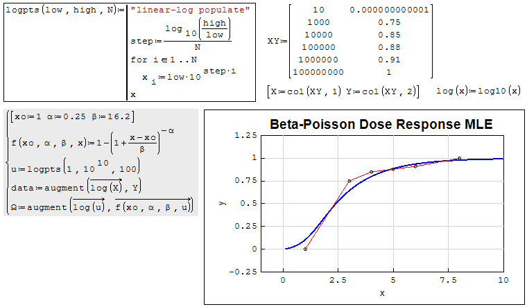

... else than Bode.
Utilities logpts [Beta_Poisson].sm (9,4 КиБ) скачан 1090 раз(а).

... else than Bode.
... more USER
Utilities logpts [Beta_Poisson].sm (13,52 КиБ) скачан 1077 раз(а).

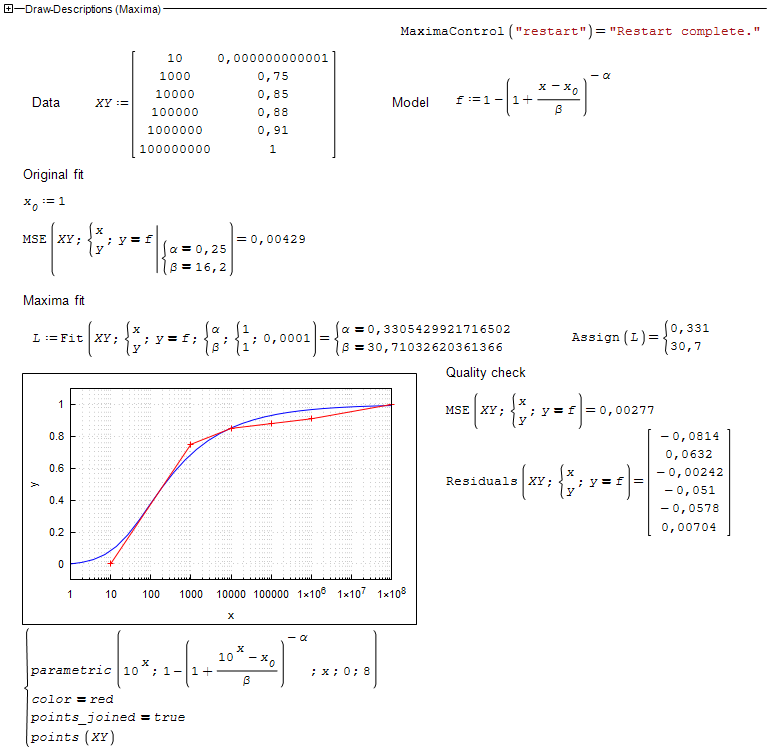

Here is a Maxima version, including the fit procedure. Note the use of parametric() in order to get evenly distributed points in the log plot.
logplot.sm (145,83 КиБ) скачан 1363 раз(а).

1. added the source experiment notes
2. added Weibull MLE example.
Utilities logpts [Beta_Poisson].sm (353,86 КиБ) скачан 1226 раз(а).
