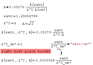

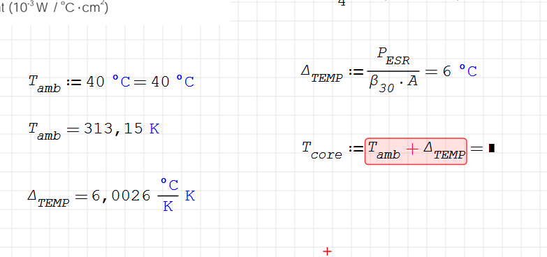

Hello, I would like to consult you
                                                I define a temperature in degrees Centigrade, when I call it it looks like Kelvin degrees and then I can't make a sum because it tells me they are two different units. How can I do so that the defined temperature is maintained in every calculation in the unit that defined it?
Attached image capture of the problem.
Thank you
#9 Опубликовано: 29.09.2019 04:22:37
There are many posts on the Forum about handling tempereture units. See for example this one.

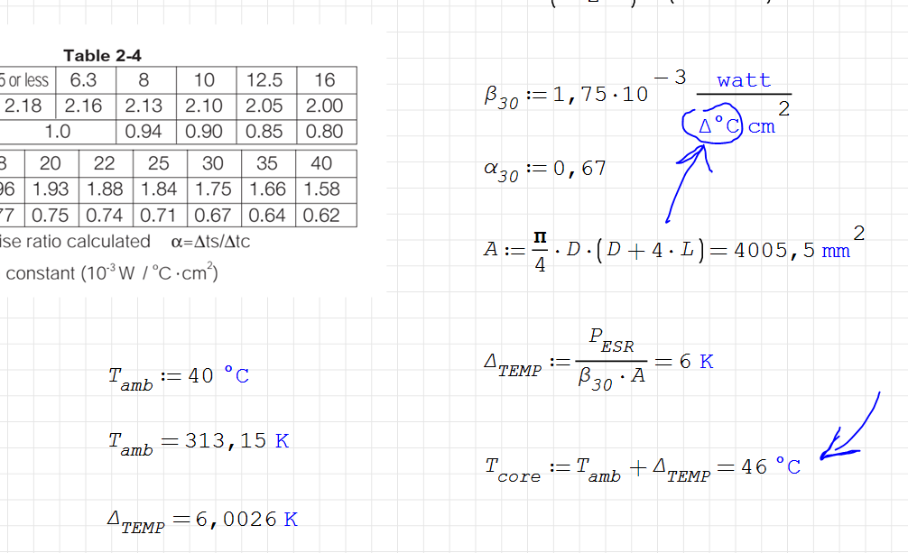

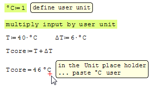

#10 Опубликовано: 29.09.2019 07:46:27
Smath Unit System is ISO, °C is not ISO.
Define your user unit.
If user unit is not '1', don't multiply input by user.
frapuano 29.09.2019 08:28:00

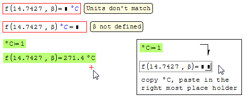

#15 Опубликовано: 29.09.2019 22:06:13
The difference operator is often useful.
