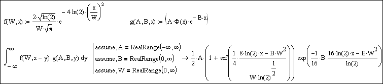

However, Smath proceeds the convolution integral alright.
Convolution Numerical [WORKING model].sm (33,32 КиБ) скачан 1125 раз(а).
Convolution Numerical [Unsolved MCD] Copy.sm (243,32 КиБ) скачан 1184 раз(а).
