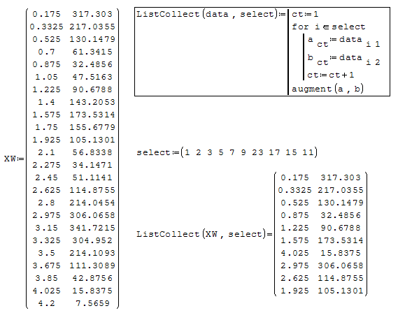

The data table can be any size, search any rows/any col.
Just modify/adapt to your project.
