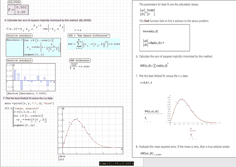

Reviewing the Levenberg Marquardt Method with a Jacobian matrix for finite differences,
solving an example taken from the website:
http://support.ptc.com/help/mathcad/en/index.html#page/PTC_Mathcad_Help/example_using_minerr_for_nonlinear_least_squares_fitting.htm .
Algorithm_Levenberg_M_with_DF_SS7251.sm (210,01 КиБ) скачан 1354 раз(а).
Algorithm_Levenberg_M_with_DF_SS7251.pdf (569,73 КиБ) скачан 849 раз(а).

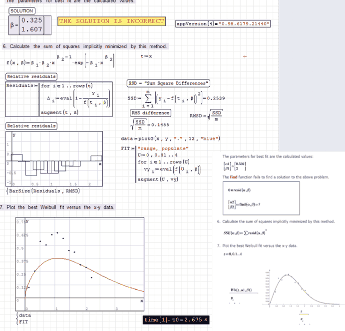

I tried to run the algorithm of Levenberg Marquardt, in the version of SS6179,
but it inevitably fails, giving an incorrect solution.
It seems that the error could be in some operation where a single value vector
is produced. Could you take a look to see if you can doctorate ?.
I post again the version of the algorithm in SS7251 with some minor changes.
Algorithm_Levenberg_M_with_DF_SS6179.sm (513,58 КиБ) скачан 1370 раз(а).
Algorithm_Levenberg_M_with_DF_SS7251_R1.sm (209,94 КиБ) скачан 1385 раз(а).
Carlos

The question is: Why does the SS7251 version directly obtain the solution,
changing the values correctly of the β variable, while the SS6179 version does not,
and they have to be manually entered as new values of the vector of the assumed initial solution. ?
The algorithm is the same for the 2 versions of SmathStudio, so what is the difference if the
programming and decision definitions are supposed to work the same?

A most interesting observation !
SS 6179 may have to do with the conditional statement.
SS 6179 is "zero" tolerance. So, it may just navigate then end.
It could be SS 7251 conditional is coded more tolerant
Mathcad style and reaches convergence ? Watson, are you there ?

Hola Carlos. Just check the code from the SS6179 version, in the while not(stop) loop, the line with A:=J^T*f is wrong, it must to be A:=J^T*J.
Thanks Alvaro ... doctored !
Hola Alvaro.
Muchas gracias por tu corrección.
Cuando copie y pegue directamente el codigo de SS7251 a SS6179 daba el error de
"Ecuacion demasiado larga para visualizarla" con un tiempo de ejecusion de mas de 7 minutos,
por lo que opté por copiar manualmente el codigo, pensando que las declaraciones eran interpretados erroneamente, y
fue cuando copie mal la formula.
Hello Alvaro.
Thank you very much for your correction.
When copying and pasting directly the code from SS7251 to SS6179 it gave the error of
"Equation too long to display" with an execution time of more than 7 minutes,
So I chose to manually copy the code, thinking that the statements were misinterpreted, and
It was when I copied the formula badly.
