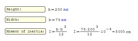

One solution might be write the calculations twice. It's not optimal, but it works. An added problem is the units.
Learning by doing
IVR 24.03.2014 05:07:00
#7 Опубликовано: 22.03.2014 09:22:32
1 357 сообщений из 2 271 понравились пользователям.
The cm unit seems to be placed as separate region (text or math) right to the result. In order to get this right, you might place another region showing 4 to fake the exponent. Or just use a math region.
I would not vote in favour of writing the same input twice. If you want to change an input value, you would need to scan the complete worksheet for occurences of the values. What if a stupid user assumes that he is done with assigning the values to the corresponding variables? That sounds dangerous to me.
