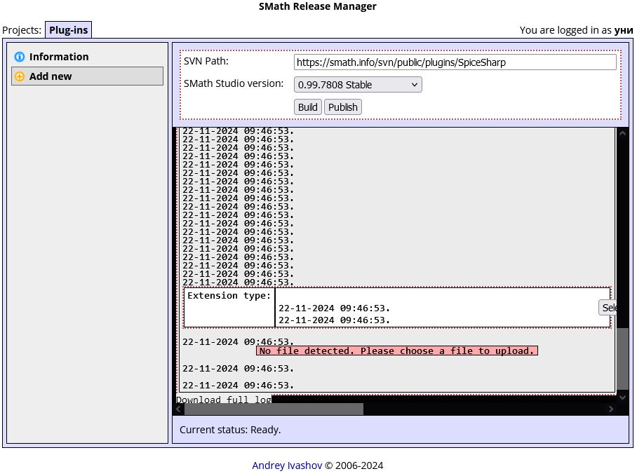

I can't publish the plugin

Группа: Super Administrator
Issue is troubleshot.
The reason is that the file of the plug-in is 35.5 MB which is the largest plugin right now. Server does not accept such amount of bytes because of security reasons.
Current maximum request limit is 30,000,000 bytes, which is approximately 28.6 MB.
I'm checking what can be done here...

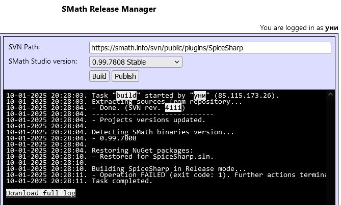

There is no log, the reason is unknown.

If you click on the Download full log link at the bottom you'll see the following error:
"error NETSDK1050: The version of Microsoft.NET.Sdk used by this project is insufficient to support references to libraries targeting .NET Standard 1.5 or higher. Please install version 2.0 or higher of the .NET Core SDK."
Will try to install latest .Net SDK.
As I wrote earlier, this log has not been displayed for me for many years. When I try to download it, I get an error: File not found.
