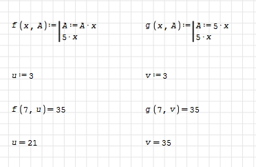

Hi. The only way I know for a function to modify a variable is to pass it by reference to the function.
#3 Опубликовано: 01.07.2021 00:03:51
stephen16
stephen16
Hi Alvaro,
Thank you for your reply. How do I do that? Could you share some sample.
#4 Опубликовано: 01.07.2021 00:12:28
1 118 сообщений из 1 794 понравились пользователям.
Hi.
example_by_ref.sm (4,86 КиБ) скачан 1039 раз(а).

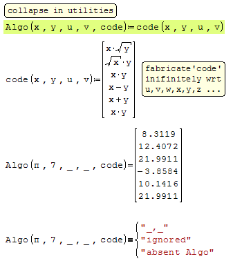

#5 Опубликовано: 01.07.2021 08:35:00
Native Smath has the exceptional feature of being algo style.
You can do what you want from in-situ command line.
Oscar Campo 01.07.2021 10:50:00
