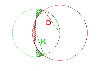

Is it possible to make a type of shading like the one shown in the figure?

WroteIt is possible to make a type of shading like the one shown in the figure
Thanks Carlos, superb.
You can have it shaded in all web colors as well.
I didn't add the arrows ... The two circles could
be done unicolor via rkfixed.

CBG, your algorithm for drawing a circle can be simplified.

Hola Carlos.
Beside Jean's random hatch, you can also fill a region with brute force algorithms, or using CreateMesh, with some restrictions (Origin must to be inside the region).
