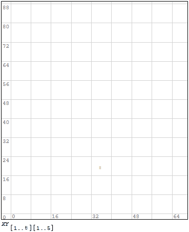

Is it possible to create in SMath this game
Maybe not that specific game.
Maybe, a photo pixel extract, from similar context.
Cheers Jean
Valery Image.sm (2,06 МиБ) скачан 1532 раз(а).

Thanks, but I am waiting an animation of the my game - Gues Image!
One color variant

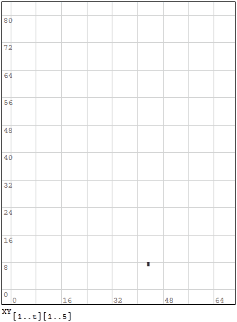

This is a way.
che.sm (257,78 КиБ) скачан 1552 раз(а).
This is a way.
Fine! Thanks!
But now with color! Please!
The red star at the Che hut!
Or red lips at MM!

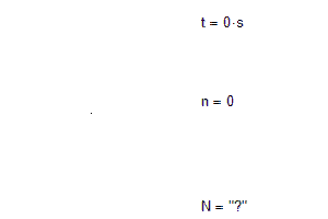

#8 Опубликовано: 03.05.2023 03:35:39
Or red lips at MM!
That could be much more complicated. Code is from this post:
EP_NO.sm (61,81 КиБ) скачан 1463 раз(а).

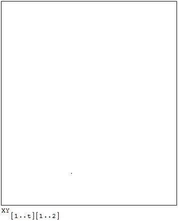

#10 Опубликовано: 03.05.2023 16:29:11
... And now we need not a portrait, but a sculpture!
Not that, but at least you can more or less play with this version.
GuessImageGame.sm (107,82 КиБ) скачан 1492 раз(а).

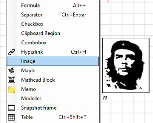

#12 Опубликовано: 20.10.2023 15:55:47
From the insert menu
