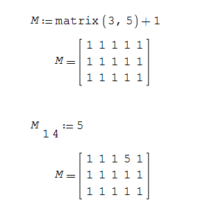

#3 Опубликовано: 28.09.2021 08:37:33

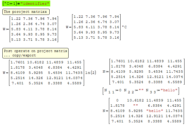

#4 Опубликовано: 28.09.2021 09:17:41
... observe the empty place holder is a / operator.

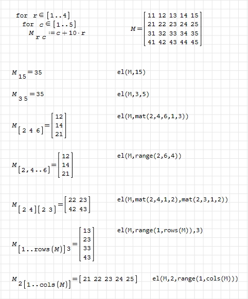

Hi. There are many different ways to access the elements of an array. This list is not exhaustive, and does not include the submatrix function.
M.sm (10,01 КиБ) скачан 1031 раз(а).

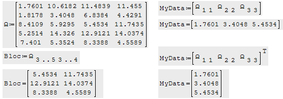

Thank you so much, especially for the examples (Jean, Davide, Razonar). It brightened up a lot of problems for me regarding matrices. Once again, thank you very much. One more thing, how do you write the range of elements in an array? Regards Adam
#10 Опубликовано: 30.09.2021 07:53:25
Your question is not clear w/o an example.
If not confidential, please attach the document.
Attached, a typical example @ the red arrow.
Cheers ... Jean.
2D Plot Multitrace [Gaussian] QUICK.sm (26,2 КиБ) скачан 894 раз(а).
