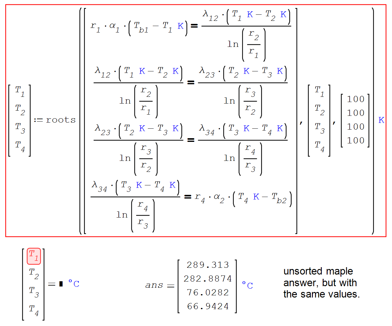

I would like to to sole the linear equations
F1=F2=f3=F4 with 4 unknowns T1, T2, T3 and T4
I can do it in Mathcad (given-find). but cannot in SMath ;-(
Help me please!
See please the Mathcad Calculation Server
http://twt.mpei.ac.ru/MCS/Worksheets/Thermal/Heat-Flow-3radius.xmcd
my SMath try in attach and
Lambda3.sm (434,36 КиБ) скачан 1041 раз(а).

Hi. Here two options for solve the system.
Lambda3.sm (452,05 КиБ) скачан 1058 раз(а).

I see Alvaro has beaten me to it, but here's my approach anyway.
Lambda3b.sm (470,18 КиБ) скачан 1117 раз(а).

Thanks to all!
My solution in attach
Lambda3.sm (265,4 КиБ) скачан 1039 раз(а).
