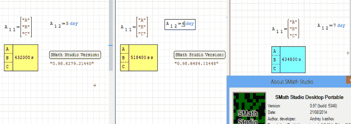

Hello "ndtm", Jean, "overlord" and Sergio.
Thank you very much for your comments, recommendations, suggestions and help.
It seems that it is a Bug in Smath Studio 0.98.6606, since I tested it in the
versions of Smath Studio 0.98.6179, 98.6484 and 0.97.5346, and in
these versions it worked correctly.
Carlos
