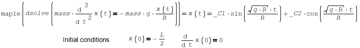

#4 Опубликовано: 01.07.2023 10:51:35
Valery Ochkov
Valery Ochkov
67 сообщений из 716 понравились пользователям.
Thanks!
But no way to do so in SMath
"L & m" are missing in dsolve result ?
m is missing in dsolve.

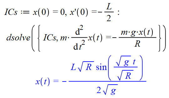

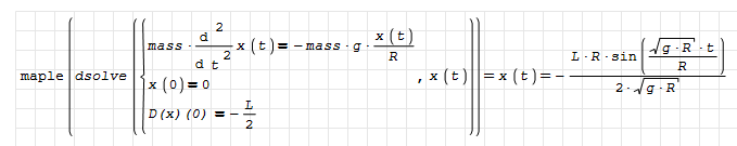

#5 Опубликовано: 01.07.2023 14:48:44
See please one ODE symbolic solution without IC
Hi Valery. Use Ctrl+Shift+K for write D(x)(0), which means x'(0)
Valery Ochkov 02.07.2023 04:05:00
#6 Опубликовано: 02.07.2023 04:06:01
Valery Ochkov
Valery Ochkov
Thanks!
dsolve-ICs.sm (10,61 КиБ) скачан 1541 раз(а).

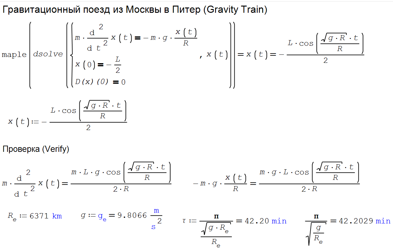

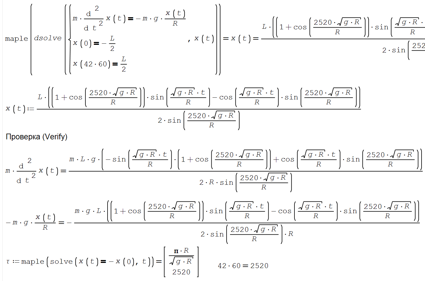

#7 Опубликовано: 03.07.2023 03:43:12
The distance between the cities added.
GravityTrain.sm (31,01 КиБ) скачан 1467 раз(а).
GravityTrain.pdf (233,1 КиБ) скачан 937 раз(а).

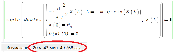

#10 Опубликовано: 04.07.2023 09:30:11
Valery Ochkov
Valery Ochkov
A pendulum
#11 Опубликовано: 04.07.2023 18:53:08
A pendulum ...
The exact solution needs some handwrite work.
Edited: a hard handwrite work. Previous version was wrong.
Click to enlarge
Correct solution -> pendulum v2.sm (13,73 КиБ) скачан 1473 раз(а).
Wrong solution -> pendulum.sm (13,88 КиБ) скачан 1480 раз(а).
Valery Ochkov 05.07.2023 06:23:00
