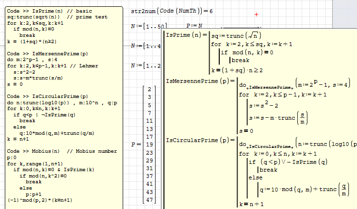

This function take the script in the variable description and try to convert it into a SMath function.
Code.sm (43,79 КиБ) скачан 1687 раз(а).
Code.pdf (185,65 КиБ) скачан 1026 раз(а).

Updated for if(2), if(3) and if(4).
Code.sm (58,16 КиБ) скачан 1592 раз(а).
Code.pdf (244,84 КиБ) скачан 977 раз(а).

Updated. Some few new features added.
Code.pdf (606,82 КиБ) скачан 1017 раз(а).
Code.sm (111,07 КиБ) скачан 1607 раз(а).
