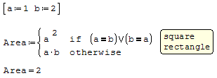

#4 Опубликовано: 17.07.2019 12:33:43
... define A:=
in the place holder, click f(x) menu
browse for 'cases', select, insert.

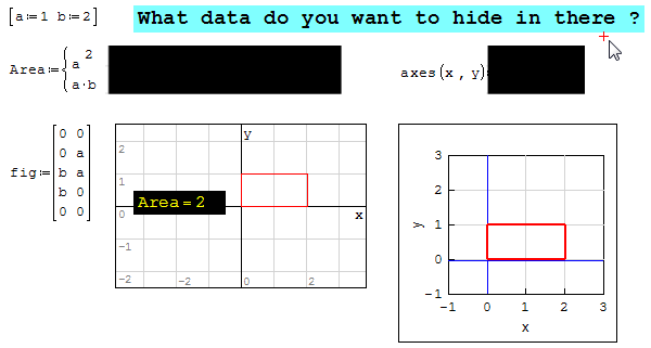

Hi. This is something like you want, but it could be very hard to implement, except for images and some few equations, as in the attached. Playing with include and run utilities, can have more dynamic results.
Examples.zip (115,76 КиБ) скачан 371 раз(а).
frapuano 18.07.2019 07:51:00

#11 Опубликовано: 18.07.2019 10:55:10
is it possible to make visibility of formula or region false or true?
Answer is NO immediately by 1/0 logic ... Alternately
1. background black those math regions black is [1,1,1]
2. create a black image, capture with Wingrab [freeware]
... select/crop the black region in Wingrab
... paste that black image in Smath
... now in Smath you can re-paste as many as wanted
... slide the black over the regions
... by the handles you size the black master as desired
Another approach is to put the math regions in a Formatted Label
black the all maths in Formatted Label all at once
as well, if those regions aren't use: disable Formatted Label.
Borrowing bits and pieces from here and there that makes a soup project.
A project that is not stand alone will not pass Quality Control.
Page18.sm (9,41 КиБ) скачан 1203 раз(а).
