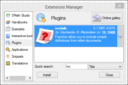

I found the plugin copy the DLL to smath plugin dir but when run smath get error: The following plugin cannot be start GUID.... Access to path c:\Program Files (x86)\SMath Stdio\plugins\log.txt is denied
WroteI found the plugin copy the DLL to smath plugin dir but when run smath get error: The following plugin cannot be start GUID.... Access to path c:\Program Files (x86)\SMath Stdio\plugins\log.txt is denied
Please, never put/edit/remove any files from c:\Program Files (x86)\SMath Stdio\.
Use Tools > Plugins from SMath Studio main menu, switch to Online gallery and install plug-in:
P.S.: Do not forget to revert changes from c:\Program Files (x86)\SMath Stdio\plugins\.
