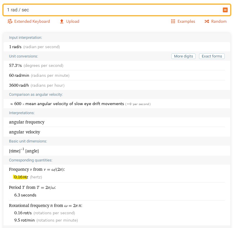

I need an assistance to understand the situation with radians.
Yesterday I had the following discussion by e-mail:
Q: "Achtung! 1Hz=1rad/s. I believe the conversion between Herz and rad/s should use a factor of 2*Pi - that is one hertz, being a complete cycle or revolution per second, describes an angle of 2*Pi radians per second."
A: "I can explain the logic of the program: rad is dimensionless unit (1m/1m), so it is equal to 1. 1/s is a Hz."
Q: "What I' m suggesting is 1 Hz = 6.283185307179586476925286766559 rad/s"
A: "Problem is that by definition radian is 180deg/pi=1. But you propose to change the definition of the radian to 2pi - this is wrong."
Q: "The radian is an angle that spans an arc with the length equal with the radius. It is equal with 180°/Pi, as you mentioned. Please google "convert hertz to rad/s". The ratio is not 1, but 2*Pi."
Obviously this good man is right radian per second is not the same as 1/s. But what I do not understand is how it is possible that rad is dimensionless but its relation to a second is not that simple?
This question maybe stupid, but I'm not actually a mathematician so please forgive me for this
See also:
  • https://math.stackexchange.com/questions/803955/why-radian-is-dimensionless
  • https://www.wolframalpha.com/input/?i=1+rad+%2F+sec
  • https://en.wikipedia.org/wiki/Radian

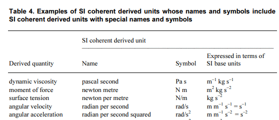

Nope. radian per second it is 1/s. In can't derive that from the animation, check the Official standard, from https://www.bipm.org/utils/common/pdf/si_brochure_8_en.pdf
Pages 119 - 120
Thus, SMath it's correct. Maybe what your friend needs to use is rpm, which have also a correct definition in SMath. It isn't in the BIPM bureau but can find it at NIST: https://physics.nist.gov/cuu/pdf/sp811.pdf

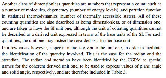

Hi. Perhaps I did not emphasize enough this important phrase on page 120 of the paper from the Bureau International des Poids et Mesures ( https://www.bipm.org/utils/common/pdf/si_brochure_8_en.pdf ) that may be enlightening to your friend:

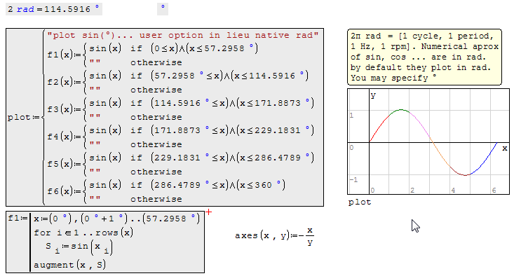

1rad/s reflects the speed of a flat angular motion [circular/elliptical motion]
More confusing is the numerical approximation of sin(x), cos(x) ...
The argument 'x' is rad.
The visitors may complete the X_Y plot attached.
Maths sin(deg) plot.sm (17,61 КиБ) скачан 1105 раз(а).
#5 Опубликовано: 19.12.2020 18:02:11
2 342 сообщений из 4 041 понравились пользователям.
Группа: Super Administrator
Thank you very much Razonar!
I've checked WolframAlpha and some converters online and I see that these tools understands the difference between Hz and rad/s.
F.e: https://www.wolframalpha.com/input/?i=1+rad+%2F+sec
See the line about Hz. Don't we need this in SMath Studio?
Many thanks for your time!

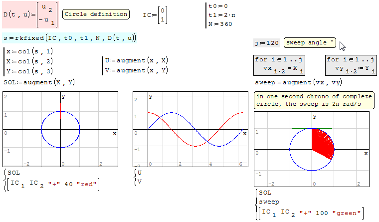

2*π rad/s [360°/s] => [1 revolution/s, 1 cycle/s, 1 period/s, 1 Hz]
By definition, 1 Hz is one period/s ... no matter the shape of the period.
As well, it may be represented by a bloc of data.

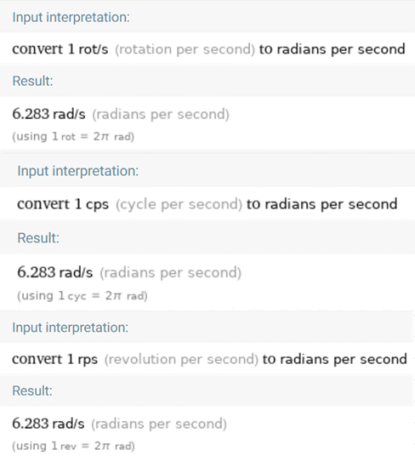

Hi. You can introduce definitions for cycle, rotation and revolution. In Wolfram alpha all are the same, but I think you might find this discussion interesting, where my choice for cycle is cycle:=1, not 2 Pi.
https://community.ptc.com/t5/PTC-Mathcad/Curve-fitting-units/m-p/499667
Naming rev or rot as 'rev:=2*Pi you can handle those values that appear in wolfram alpha.
From https://www.wolframalpha.com/input/?i=rot+%2Fs+in+rad%2Fs and similar:

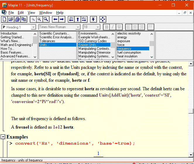

Finally, you can implement more complicate solutions, like this one in maple:
