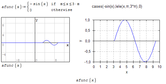

The sample code shows what works and what doesn't. I think the issue is in zed_graph as 2D works. It stops working when the if is added to the function zedgraph example.sm (151,36 КиБ) скачан 1478 раз(а).
Seems that Zedgraph can't handle if(). It also fails at non-numeric or undefined values.
A workaround for if() is the use of cases() from Customfunctions plugin. It converts into a boolean expression, which can be handled by Zedgraph.
Suppressing parts of a curve by making it undefined doesn't work. You just can set it to zero.

I really like the afunc syntax and I am sorry but Newbie I am. How did you get the if after -sin(x)
Hi mkraska
worked it out. types in cases; thank

There is no issue: you can plot contiguous pieces of same function,
or any selected pieces. You can have as many different functions
as you wish of both styles.
Please, revisit just new "2D plot Piecewise" in Samples.
