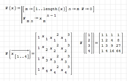

is there an inline-variant of the loop mentioned in the picture,
loop
because when i try to add an index to the function w(x) it throws a syntax error.

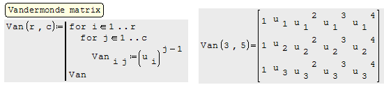

Hi Crang. This could be an option
VandermondeMatrix.sm (6,99 КиБ) скачан 1099 раз(а).

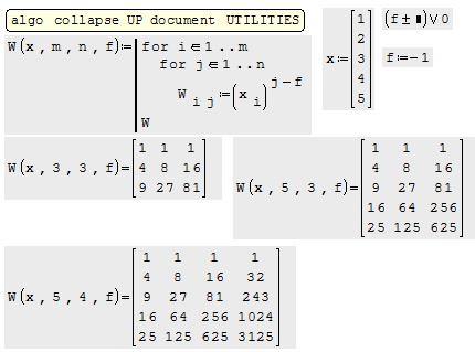

Make it algo style for infinite local use.
Cheers ... Jean.
#4 Опубликовано: 25.05.2022 19:38:47
... make Vandermonde algo style for any local symbolic/numeric
