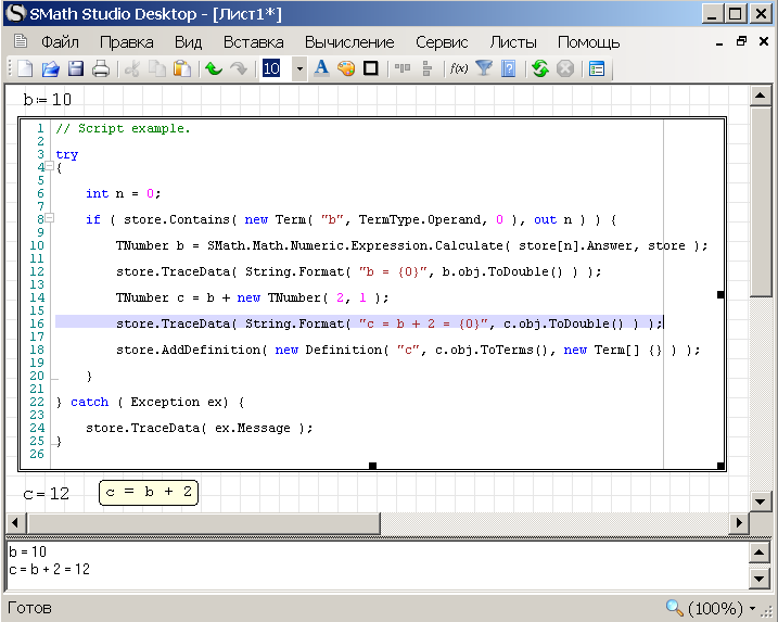

I think it will be available this summer.

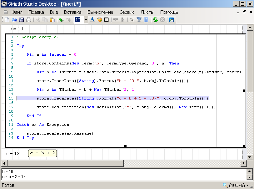

VB.Net script example.

Now I have an editor (Memo). The compiler for C# and VB.Net languages ​​I also have. It remains to combine them.
