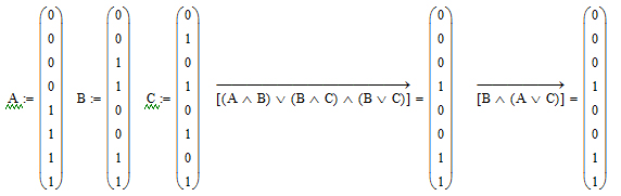

Hi Davide and Jean,
Thanks for your prompt replies, I appreciate your efforts.
Unfortunately, as I am showing other students how to use logic, I wanted something simple for them to use. In Mathcad 15 it is easy to show an original expression, and alongside it a simplified expression resulting from using Boolean Algebra, and I was hoping that SMath Studio would do the same, as I do not expect my fellow students to pay for a copy of Mathcad. Unfortunately, SMath Studio does not have to option of a simple use for logic on vectors as does Mathcad 15 (see attached .jpg image from Mathcad 15 - I hope this works, as this is the first time I have tried to attach an image).
Once again, thanks for your assistance.
Eddie

if you want to automate the operation, then define two functions as those suggested by Jean. The aesthetic result is not comparable, but the functionality yes
[albumimg]1428[/albumimg]
... automate much simpler and more general.

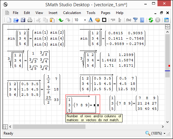

WroteFYI, I'm currently working on this feature.
Yes, please, thank you Andrey.
Maybe next: fft and picture operator.
In the mean time, "Vectorise EXPRESS"
for user to adapt wrt applicable project
Utilities Matrix Vectorise EXPRESS.sm (27,61 КиБ) скачан 1253 раз(а).
Regarding initial question: see vectorize(..) function into new nightly build release: http://en.smath.info/forum/yaf_postst7329_SMath-Studio-0-98-5908--05-March-2016.aspx
