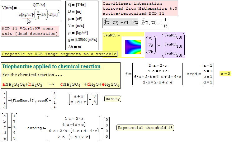

Can you imagine Unicode in the attached ?
Jean ... however Bravissimo for the effort, Franco !
Inst_pH Solution.sm (46,8 КиБ) скачан 1139 раз(а).
