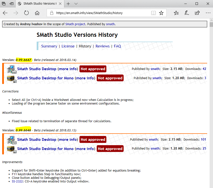

#13 Опубликовано: 14.03.2018 16:46:36
Группа: Super Administrator
Thank you Jason and Sergio!
I've reproduced this issue and it is introduced exactly in 0.99.6646.
I'm working to figure out the reason and fix it asap.
The following SMath Studio nightly builds are marked as NOT APPROVED and will not be suggested to download to anyone anymore: 0.99.6646, 0.99.6647!
