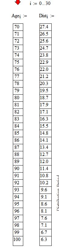

I am a long-time user of Mathcad. I cannot find a way to enter data into Smath. It seems range variables are not the same as in Mathcad. Do I need to enter data into a vector? If so, how do I define the vector of say 30 elements and then proceed to enter data into each of the 30 elements. All documentation provided does not make this clear. See attached image from Mathcad to see what I am trying to implement in Smath.

The Dist vector elements do not come from a formula. They are individual data points. Do I create a vector of 30 rows and then click on each element to enter the dats or is there a more convenient method like Mathcad where you just hit enter to go to the next element to enter that value?
Thanks

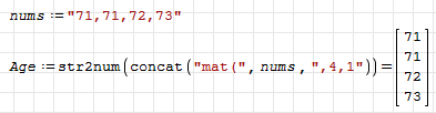

#4 Опубликовано: 14.02.2019 17:29:33
1 555 сообщений из 1 865 понравились пользователям.
You can do it like this.
Andrey Ivashov 14.02.2019 18:46:00

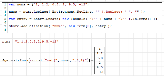

#5 Опубликовано: 14.02.2019 17:44:13
More difficult way with using Script region.
