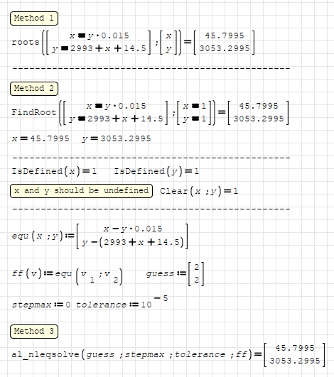

#2 Опубликовано: 01.01.2022 07:59:32
how to get the result of x, y without using the matrix? I tried solve and findroot, but can't get the value of x, y.
You can't use solve() for nonlinear equations. (more than one unknowns)
You can use roots(), FindRoot() or al_nleqsolve().
Here is your equation solved in various ways.
solvers.sm (10,77 КиБ) скачан 1151 раз(а).

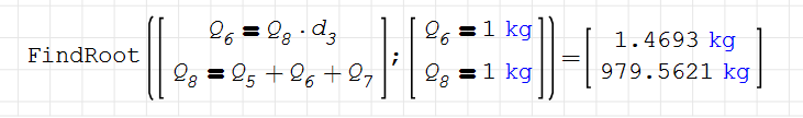

#4 Опубликовано: 01.01.2022 11:22:51
John
John
0 сообщений из 12 понравились пользователям.
Excellent reply!
FindRoot is better for my condition, I need units.
Thanks Overlord!

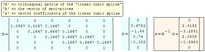

#6 Опубликовано: 01.01.2022 15:38:12
Matrix style is more commonly encountered in Engineering projects.
That example has only one CAS route ... naturally 15 D.
