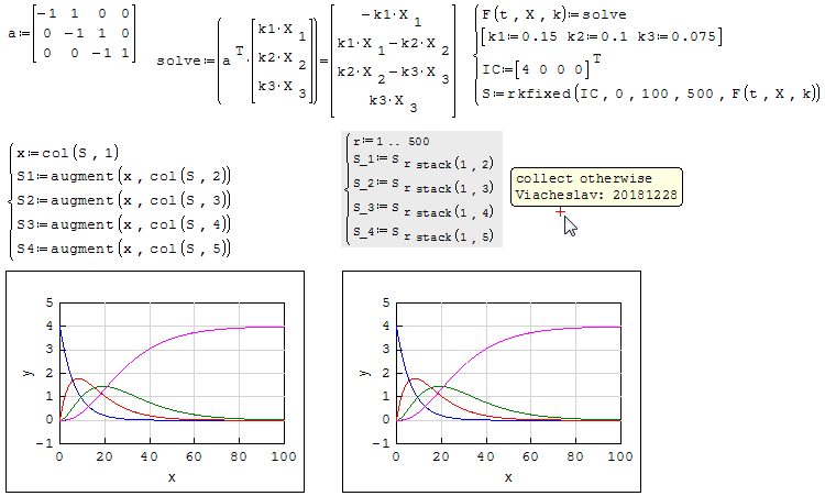

WroteThanks Viacheslav,
Works well SS 6179, lovely for publishing .
I see no point to imitate Mathcad [just personal].
Though I don't understand the objective in re-coding the ODE solvers,
the question is: will the re-coded ones support either option ?
i.e: will the re-coded support the native style ?
Think in term of the recent unacceptable bug maple(int,).
17 ODE solvers, 0 double/triple integral.
Sorry for the comment: not so glorious 6884 !
