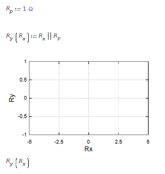

I am trying to plot electrical resistance using Electrical Engineering Library and X-Y-Plots Plugins but it does not seem to work:
Can anyone help me plot this?

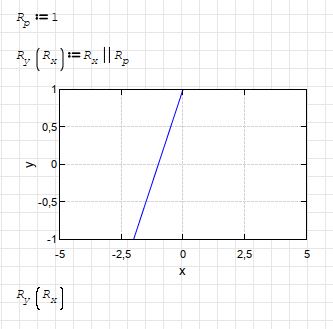

#2 Опубликовано: 16.10.2021 19:41:28
Delete the ohm unit in Rp.
Usually you shouldn't use units while plotting.
For information, this includes most numeric solver functions too.
#3 Опубликовано: 16.10.2021 19:46:20
Or if you will really need units;
Try to eliminate or add them in the input data.
It is to avoid them being used in plot.
Or to avoid conflict between unit-ed numbers and not unit-ed.
When you use Rx in your function, it can't be EEL_par with 1 ohm.
Plot try to use Rx as an number not a unit added number.
You either add unit to Rx or do opposite.
Opposite is eliminating all units of other variables.

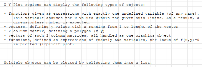

#5 Опубликовано: 17.10.2021 14:28:23
Thanks, this makes total sense.
Also, how is it possible to only plot (or "stem" as it is called in Matlab ) integer values?
Maybe I chose a wrong word to describe it, shall edit.
It will plot not only integers, numbers actually.
But plot expect them to be dimensionless.
Not just X-Y plot, built-in 2D plot also.

So how did you add the Ohm symbol under the plot? It won't let me add a unit there.
#7 Опубликовано: 17.10.2021 16:23:47
1 - Hit multiply after Rx;
2 - (Type W in place holder, place Ctrl+G) or (Click ohm from right pane);
3 - Placeholder shall appear, either double click or press tab to insert Ω as unit.
If you are not typing units after numbers, this is the way.
You can also type ' between step1 and step2.
Units can be typed or chosed with this way more quick.
This will directly open placeholder scroll menu.

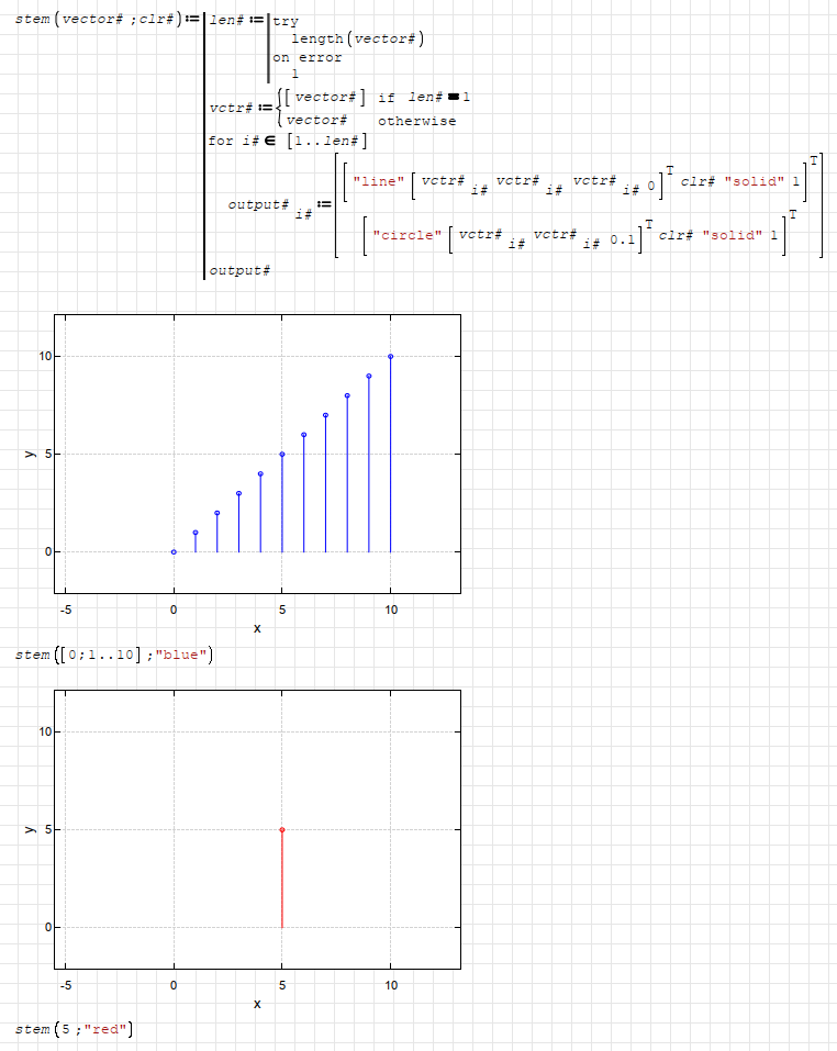

#10 Опубликовано: 18.10.2021 17:05:53
I don't know if there is a stem equivalent for smath plots.
But you can create your own function for that purpose.
stem.sm (8,62 КиБ) скачан 1088 раз(а).

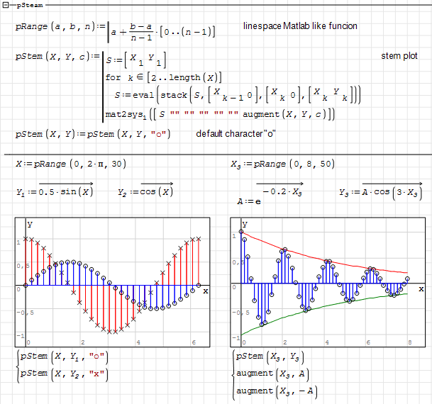

#12 Опубликовано: 19.10.2021 00:42:00
Hi. In addition to the overlord solution, this is another approach.
stem.sm (12,15 КиБ) скачан 1065 раз(а).

...In addition to the overlord solution...
Mine was not a solution to be honest.
Just a quick and ugly way to show it is possible.
This is a good solution though.
